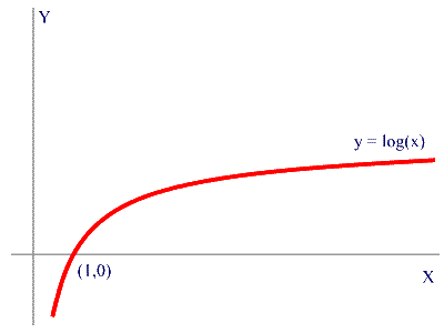

Ptuk Posted October 4, 2013 Report Share Posted October 4, 2013 Complementando al feo y al cañangasla gráfica del logaritmo, fijate donde es 0 en x Link to comment Share on other sites More sharing options...
